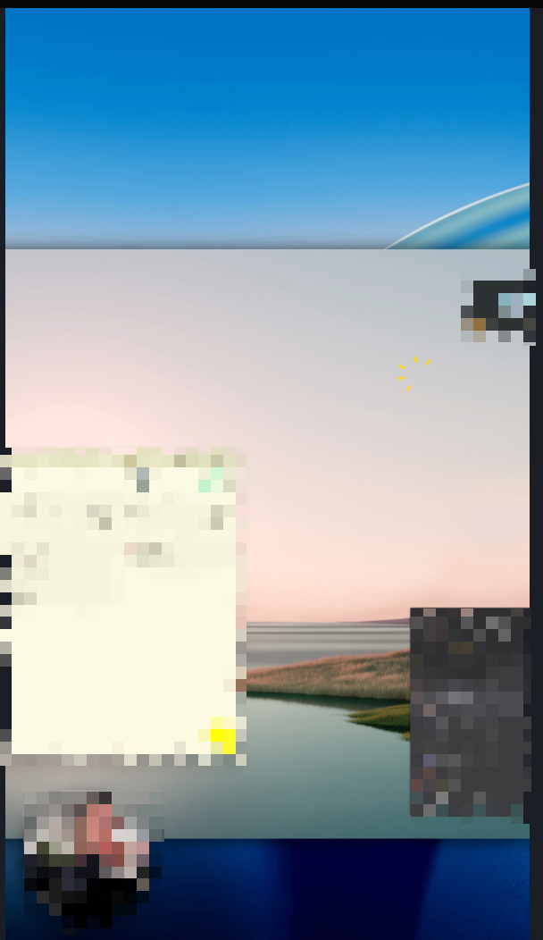

9:16竖屏模式的时候,关闭固定缩放区域的功能后,视频本身缩放时会不停向上或者向下位移同时缩放,会觉得画面很杂乱,不可以让缩放是基于中间点的轴吗,那点击了固定缩放区域,放大后画布本身又不会放大了,很矛盾的功能。
When in the vertical screen mode at 9:16, after disabling the function of the fixed zoom area, the video itself will keep moving up or down while zooming, making the picture look very messy. Can't the zoom be based on the axis of the midpoint? Also, when the fixed zoom area is clicked and the video is enlarged, the canvas itself does not get enlarged. This is a very contradictory function.

    非常抱歉给您带来困扰。关于缩放方向的问题,是由于系统会根据您在画布上的点击位置(即操作中心点)自动计算缩放变换的基准坐标。若您希望实现以画面中心为固定轴的缩放效果,建议切换到手动缩放模式,并在偏好设置中启用“固定中轴缩放”选项。此模式下,画布将保持静止,仅画面内容按中心点进行比例缩放,您可以根据创作需求自由选择适配的模式。
    英文翻译
    I apologize for the confusion. The zoom direction changes based on where you click on the canvas, as the system automatically calculates the transformation coordinates relative to your click position. If you need center-axis zooming (where the canvas remains static while only the content scales uniformly from the center), you can switch to Manual Zoom Mode and enable the "Fixed Center Zoom" option in preferences. This allows you to choose the mode that best fits your editing needs.
